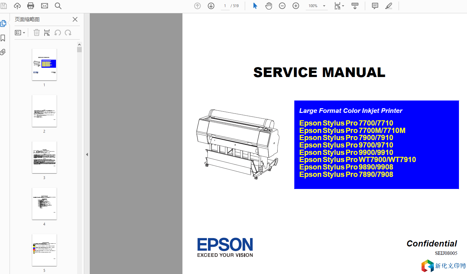

[爱普生] epson爱普生绘图仪9890_9908_9900_9910维修手册故障排错拆装资料
本手册适用于下列机型
Epson Stylus Pro 7700/7710
Epson Stylus Pro 7700M/7710M
Epson Stylus Pro 7900/7910
Epson Stylus Pro 9700/9710
Epson Stylus Pro 9900/9910
Epson Stylus Pro WT7900/WT7910
Epson Stylus Pro 9890/9908
Epson Stylus Pro 7890/7908
手册格式:pdf
文档大小:34M
手册页数:519
Revised
􀂄 Chapter 1
• "1.2.1 Basic Specifications" (p.20) : nozzle configuration has been revised.
• "1.3.3 Printable Area" (p.41) : minimum for roll paper width has been revised.
• "1.5.3 Serviceman Mode" (p.74) : "CL5" in "C/D" column in "Cleaning" menu of Epson Stylus Pro WT7900/Epson Stylus Pro WT7910has been added.
􀂄 Chapter 3
• "3.6 Remedies for Service Call Error" (p.131) : error information for 1427 and 1428 has been revised, remedies for 1A51 to 1A53, 1A39and 1A40 have been revised.
• "3.7.2.2 Cautions for using white ink" (p.153) : newly added.
􀂄 Chapter 4
• "4.4.6.1 Ink System Unit" (p.266) : caution about Wiper Cleaner Assy when replacing the Ink System Unit has been added.
• "4.4.6.5 Ink Cartridge Holder R" (p.277) etc. : part number for "SEAL RUBBER, JOINT, ASP" has been revised.
• "4.4.6.5 Ink Cartridge Holder R" (p.277) etc. : FFC installation method in reassembly has been added.
􀂄 Chapter 5
• "5.1.5 Service Program Basic Operations" (p.358) : caution for saving destination for Service Program has been added.
• "5.3.1 CR Timing Belt Tension Adjustment" (p.364) etc. : model number for sonic tension meter has been revised, input values havebeen revised.
• "5.7.8 Ink Holder Adjustment" (p.426) : caution not to insert the ink cartridges before the adjustment has been added.
􀂄 Chapter 7
• "8.2 Panel Menu Map" (p.468) : added and revised for all models.
• "8.5 Exploded Diagram" (p.490) : revised.
